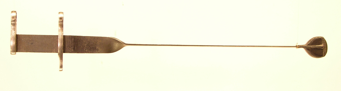

That said, when treated at that depth, one would expect photos of the M1906 and M1909. I was somewhat disappointed by their absence.
The late Bob Reuben (known fondly to west coast collectors for over 50 years as "Bayonet Bob") once told me that the only M1906 he had ever seen was the one in his collection - and which he described as a being a real dog. Apparently they really are rare. I did obtain a really nice M1909 from him, which he said at the time was VERY scarce - guess he was right!
Here is the 1909. Same (thick) bar as the 1906 but twisted 90 degrees, and with only tip covered. The 1912 would see the bar fully covered and MUCH thinner/springier. It is not at all hard to see why the 1906 (particularly) and the 1909 could cause injury.

No - THE Model 1906 was the first to be screwed on. What you show is the earlier socket type which just happened to be made in 1906. That's a very tempting item, but I'm no longer buying.
